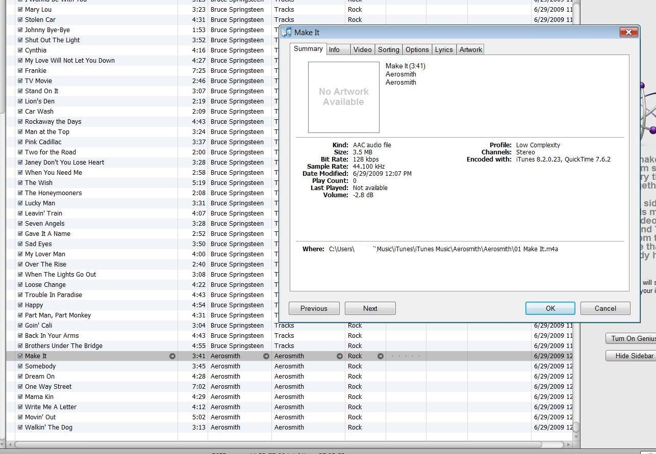

Okay, wanna talk quirky? What the fuck is up with the screwed-up album artwork iTunes automatically downloads? It's got a seriously fucked-up algorithm somewhere. So much of it is wrong, it defies belief.

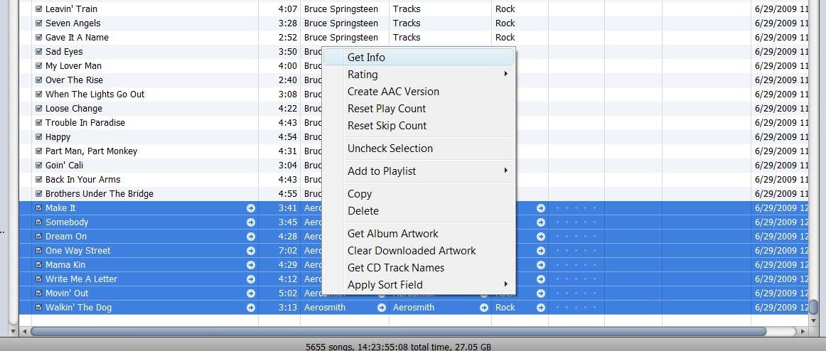

I got some screen caps, because I was having the same problem with the same albums you mentioned when I went to import them this morning. I'll have to do three posts, since the Nazi webmaster has limited us to three attachments per post. :p

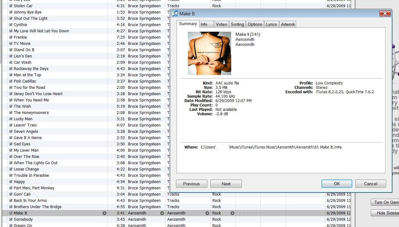

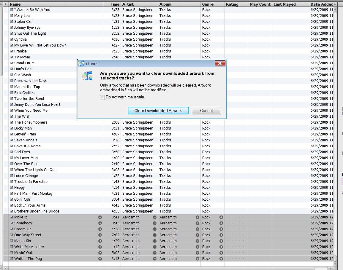

1) This is what we've both got: iTunes, for some weird-ass reason, didn't recognize the proper album when it downloaded the album artwork. 2) Select all titles that this affects and right-click. Choose "Clear Downloaded Artwork." 3) You'll probably get this warning. Need I say you should choose "Clear Downloaded Artwork"?

Re: iPods are quirky
4) As you can see, the tracks from the album now have no associated artwork. (You have to select one track rather than several to see this.)

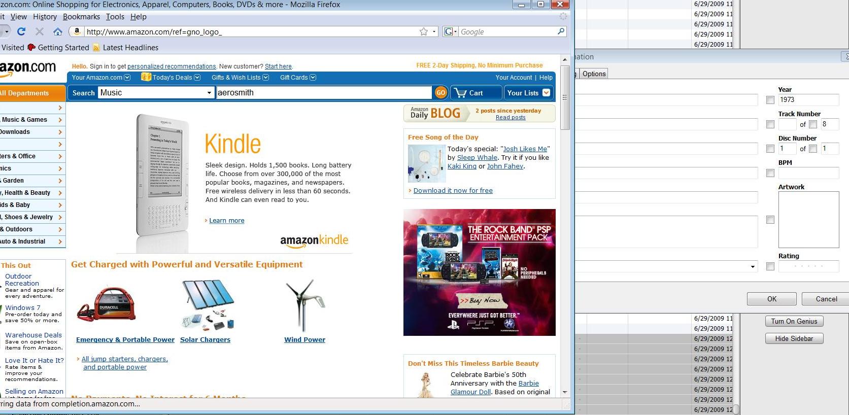

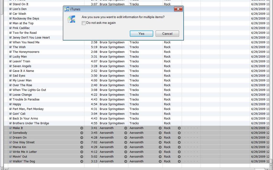

5) Select all the tracks again. Right click and choose "Get Info."
6) It'll ask if you're sure you want to get/change info on multiple tracks. Say yes. In fact, you probably should turn this warning off since it's pointless.
- Posts: 18107

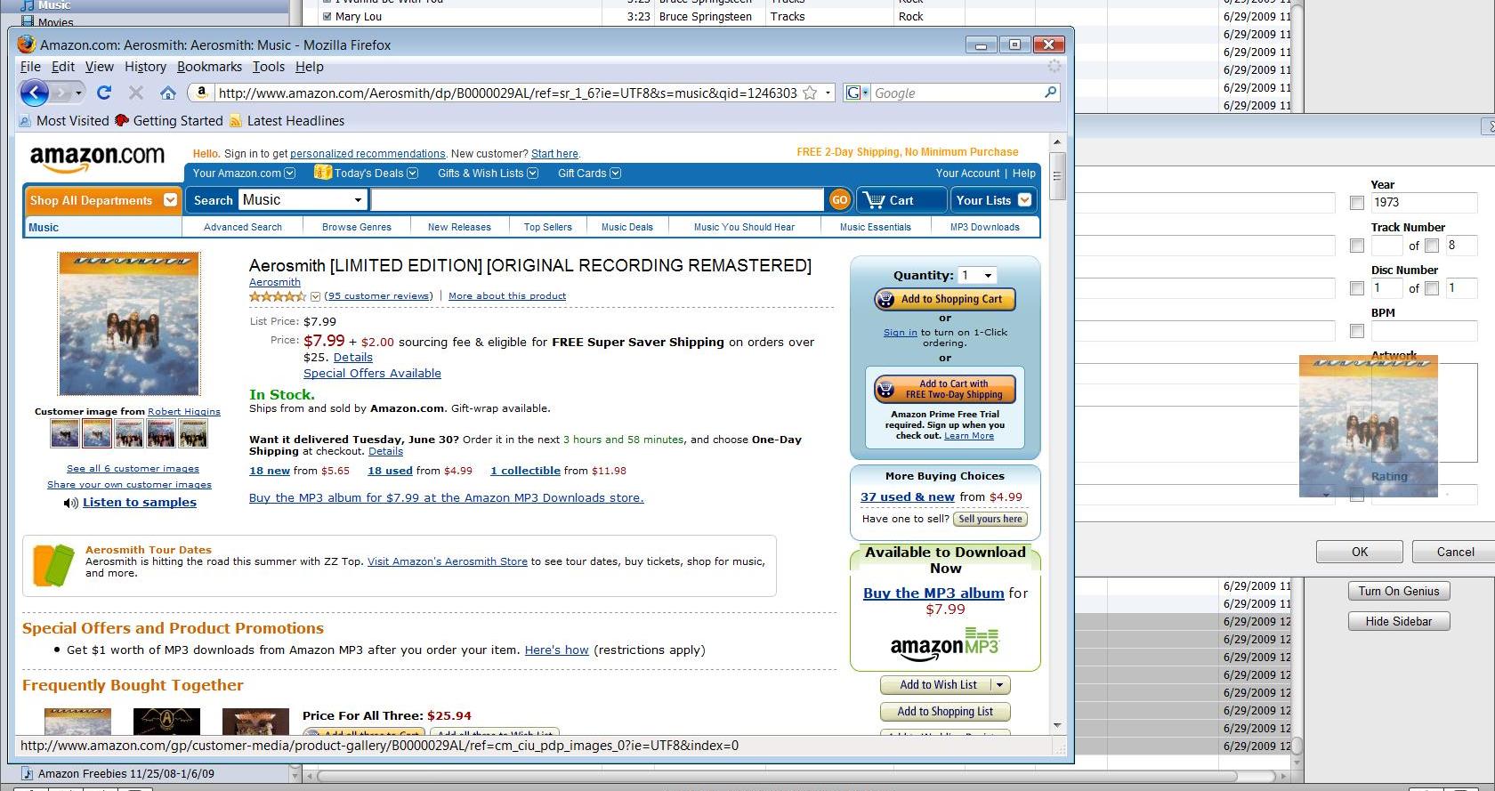

7) In Explorer, Firefox, Chrome, or whatever, open Amazon, Wikipedia, or some other site that is likely to have a shit-ton of album photos. Find the album. (Unless it's some really obscure OOP album, it should be somewhere.)
If you're on Amazon, check the customer-supplied images. Sometimes they have better color contrast or resolution. Make sure the image you get is perfectly square, if you can. (iTunes sometimes crops images. I found this out when I looked for a generic picture of the Jersey Devil to use for the Springsteen web freebie "A Night With The Jersey Devil." It was a rectangle. iTunes lopped off his head and I had to re-do it with a square version.) 8 ) Drag the image from the browser into the little tiny "Artwork" square under the Info window in iTunes. You'll see a "ghost" image. (You might want to keep track off where your pointer is in the image, since sometimes it disappears.
Once you drop it in, click OK. If you're changing artwork for multiple albums (or multiple discs of a multi-disc album), it may ask you to confirm.
